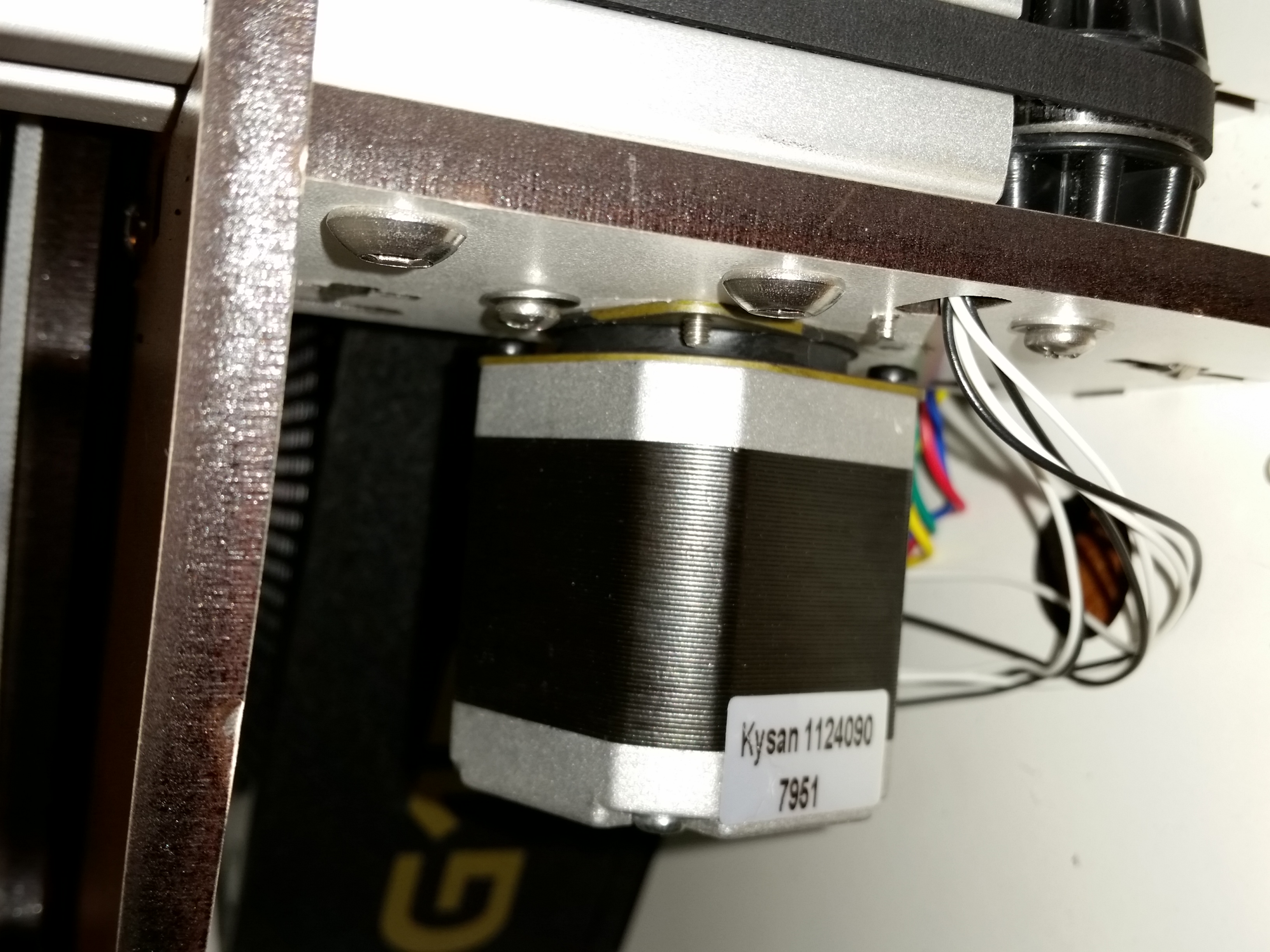

Post by BenTheRighteous » Thu Dec 11, 2014 11:18 pm
I bought some stepper motor dampers from SeeMeCNC about a month ago and was able to finally install them last weekend. I definitely didn't see the drastic change in noise that everyone mentions. It's a little quieter perhaps, but I can still hear the printer running through a closed door several rooms away. This isn't something I'd want to sit in the same room with or share an office space with all day, but people seem to think that the dampers ought to make that tolerable.
I'm pretty sure I installed them correctly - 2 screws in the stepper, 2 screws through the melamine, no screw makes contact with both objects. I'll upload a picture in a bit, but I'm wondering if something else is going on.
My first thought was that the belts were too tight, so I loosened the top idlers on all axes and that didn't seem to help.
Then I was wondering if the vibrations were somehow resonating with the platform I have the printer on, so I picked it up briefly to see if it would suddenly quiet. Nope, still noisy.
Do I just have unrealistic expectations? Or is it possible I got crummy dampers? They look exactly like the astrosyn ones here: http://astrosyn.com/section.php/44/1/vibration_dampers

I notice you have the Kysan steppers. You did adjust the voltage in the firmware, right? I have the other brand of steppers. The Kysans might be louder. I do not know. You do seem to have installed them correctly. I never had the printer going without them, but I had a home made rostock a while ago, and this is much quieter than the home made one was. It is still not silent or anything. It's tolerable.

I can confirm that the Kysan steppers are louder than the Wantai's. I've had both on my machine.
I agree with your observations. The noise from my printer doesn't bother me as much as it does you, but I'd say that the dampers reduced my overall sound level by 30% or so. I don't have any db measurements or anything to quantify it with, but it did seem like they made everybody else's machine quieter than mine :)

Shucks - so it seems like the stepper motors themselves are the culprit. They refuse to be damped, apparently! That's too bad! I did check my firmware just to make sure that I had the motor_current set correctly as the manual suggested (thanks bot) - and indeed it was.
Well, I guess if my badass-machine-of-molten-plastic-spraying-construction has to make a little noise to do its job, well, I can live with that. ;)
I don't think it's worth it to me to try and swap out the motors or dampers to see if it helps, but if anyone wants to chime in saying they damped their Kysan motors well, I'd be interested to hear it.

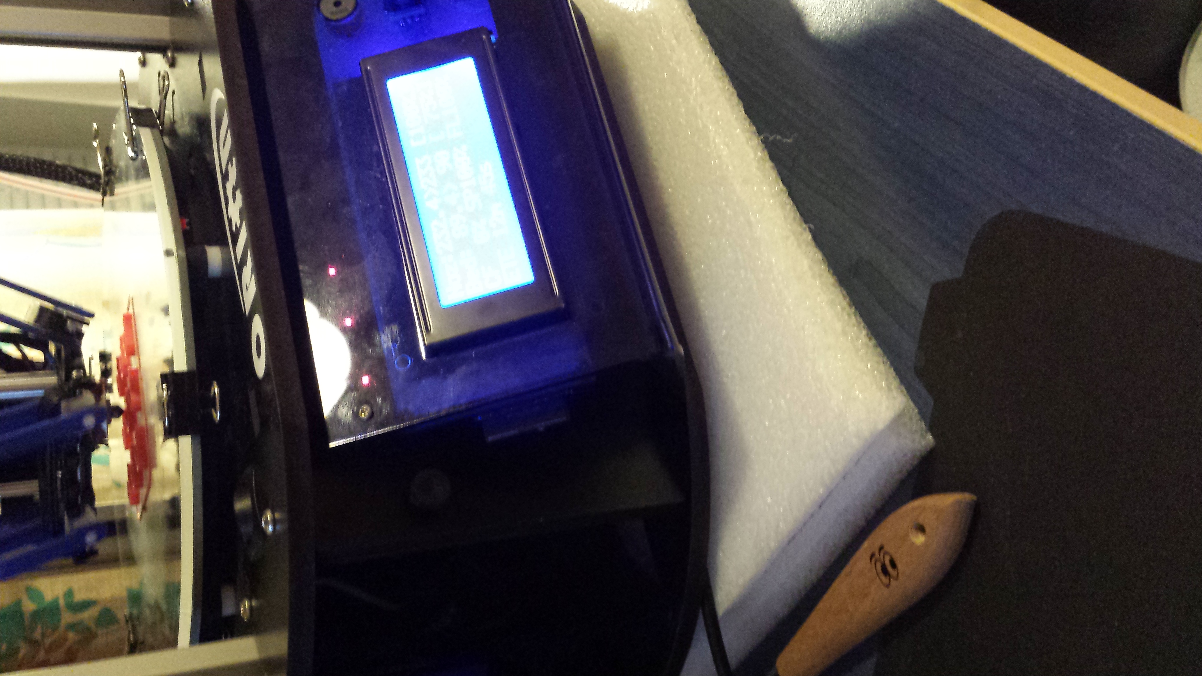

I've got mine sitting on 2X large packing foam Squares (pretty high density stuff) I got when I ordered some build plates from SeeMeCNC.. so about 3cm (2X1.5cm) and it does a very good job.
Not sure if it adversely affects print quality yet... what I've printed so far looks ok but not done anything tall yet.
Foam Packing Trial

jdurand wrote:On sound dampening, a couple of extra ideas.
If it's on a table, attach material under table to prevent it being a sounding board.
There are vibration absorbing feet and pads available for machine tools. Here's an example
http://www.use-enco.com/CGI/INSRIT?PART ... A=325-6640
I was ordering some things from Enco and so I added some of the above pads to the order. Attached is a picture of one under the Afinia printer with the RMax hot end for a size comparison. It's uploading a big job to the SD card now so I won't know how it sounds until it finishes loading (slooooow over the USB and you can't take the SD card out of the Afinina).
jdurand
Posts: 397
Re: Stepper motor dampers don't seem to be working
Post by jdurand » Tue Dec 16, 2014 10:28 pm
Printer is running and is a lot quieter. It's in a wooden box to keep it warm for ABS, the box is no longer transmitting as much noise.
I give these pads thumbs up. I got enough to also put three under the RMax when we get it assembled.
