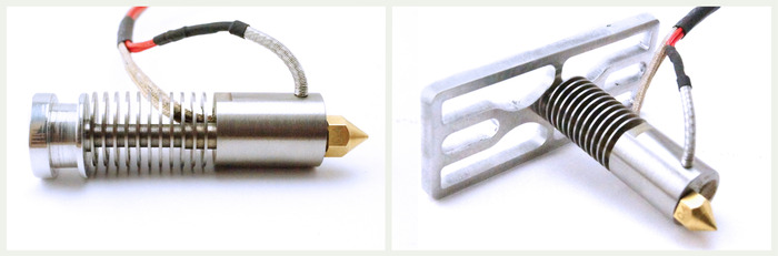

The B3 Innovations Pico Hot-End kickstarter just went live (http://www.kickstarter.com/projects/b3innovations/pico-all-metal-hotend-for-reprap-3d-printers). Just curious if anyone has been watching this hot-end. I like the thin design for being able to do dual (or triple eventually) all-metal hot-ends on my Rostock MAX. Not sure if the passive cooling will suffice with two or three in close proximity, though. Anyone have any thoughts or further insight?

dpmacri wrote:The B3 Innovations Pico Hot-End kickstarter just went live (http://www.kickstarter.com/projects/b3innovations/pico-all-metal-hotend-for-reprap-3d-printers). Just curious if anyone has been watching this hot-end. I like the thin design for being able to do dual (or triple eventually) all-metal hot-ends on my Rostock MAX. Not sure if the passive cooling will suffice with two or three in close proximity, though. Anyone have any thoughts or further insight?
It is a nice looking hot end however I do not like the length of the melt chamber. That makes me wonder how it would be for PLA.
Something like this I would rather have it out and tested before I would consider purchase.

It looks really nice and professional, and the thermistor placing is pretty nice, though Eagle is right, that is a really big melting chamber, no wonder 3mm PLA has "1.5 star rating" (whatever thats supposed to mean). if they shortened the melt zone to around half its length I think they could get better results with PLA....

Is it the length:width ratio that is an issue or total melt chamber volume?

I think total length/volume is the issue. Melting filament on a longer area like that, reduces your ability to retract filament and control the extrusion by quite a bit. In fact E3D prides itself in having a very short transition.
From their site:
....we have reduced the distance in which the plastic transitions from ambient temperatures to extrusion temperatures to 2mm. An extremely short transition from cold filament to molten plastic provides highly precise extrusion with little extrusion force.
The Pico looks very good, but I'm with others - I'd like to see it tried and tested by the DIY community first before I'd commit $$$.

I was assuming its heat sink about the same diameter as the E3D heat sink, if not then it may be fine. it looks pretty large though... length wise I was saying, it looks like a large area for it to transition from solid to melted...

If you compare the E3D and Pico groove mount diameters in pictures, it seems like the E3D cooling fin diameter is much larger than the Pico. If the groove mounts diameters are significantly different then who knows.
E3D
Image Image

0110-m-p wrote:If it is the total volume issue then maybe it is more of an optical illusion than anything else since the hot end is supposed to be very small.
It covers the whole heating element, so I'd suspect at least 10-15mm total heated height. If you melt (or at least soften) that much filament, retraction is probably near impossible.

Everyone, thanks for the input. Give what's been said, I'm concerned about the heat zone now :-P To answer a few of the questions on size, they have this picture on their website which indicates it's about as big as a AA battery: Image. And the dimensions according to the kickstarter page are 56mm high (including nozzle) and 14.3mm in diameter. Assuming the image off the temperature is accurate, then that would say there is about 9mm from 260C to 224.3C region. I suppose that would mean that the heat zone (when printing at temperatures lower than 260C) could be just a few mm, but I suspect it's still larger than the E3D.
