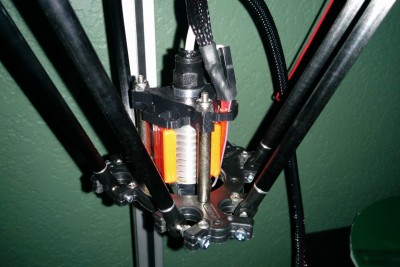

jmpreuss wrote:Were they drop in or did you have to make some adjustments (firmware or otherwise)?
They are more or less drop-in. I did adjust the Z-height, verified the bed level and slightly adjusted the printer radius as a result.
The arms are very nice.
My ORION produced great prints right out of the box with all stock parts. But the carbon arms are definitely very nice. They remove what little slop there was with the stock arms.

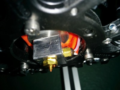

Here's the current state of my hot-end + effector plate. Re-printed the E3D mount in black (was blue), replaced the nylon spacers with metal ones and of course added the Tricklaser arms:
The new heater block for the E3D was tapped & threaded to receive an eBay screw-in thermistor:

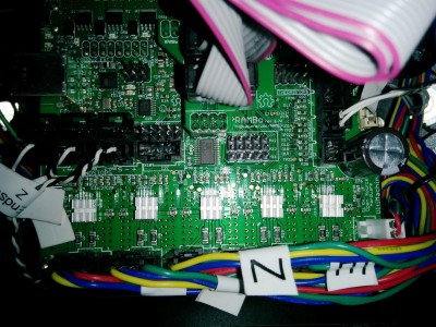

The RAMBO received heatsinks for the stepper drivers:

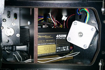

And the new power supply was mounted, opening up the space inside the ORION tremendously!

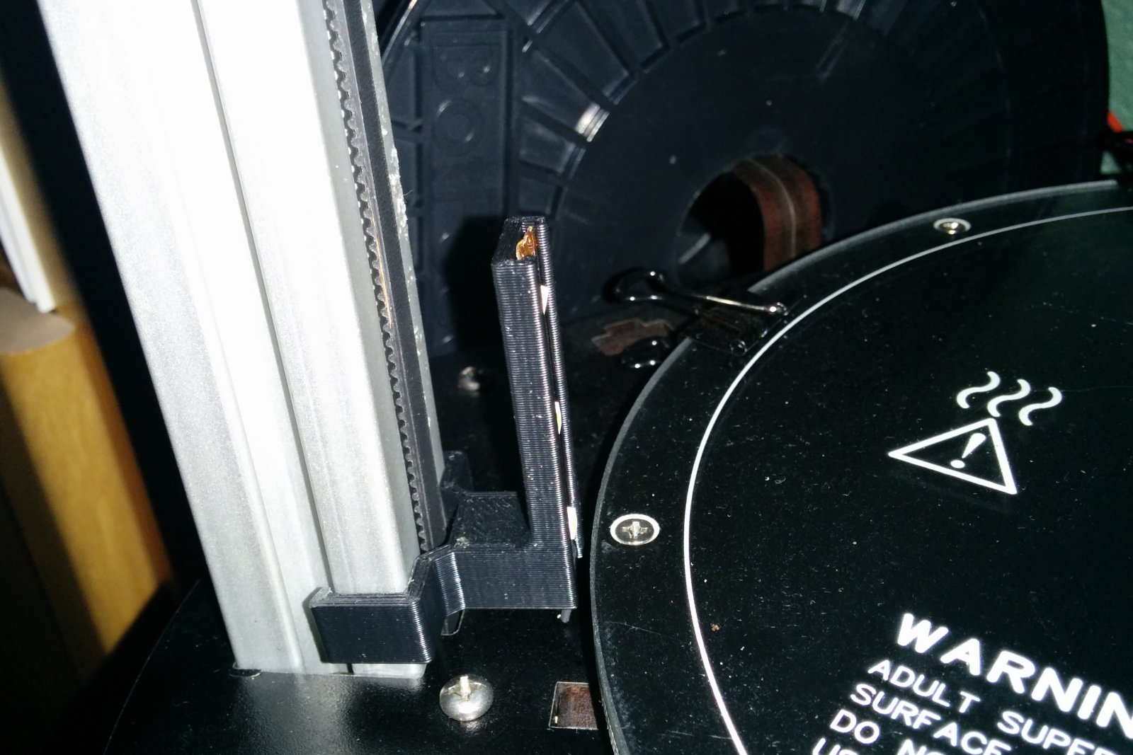

Also, I designed custom clip-on light strip mounts since, as it tuns out, glueing the LED strips straight to the extrusion can interfer with the cheapskate movements..... oops :)
New clip-on strip mounts:

Those clip on brackets you designed would be a great addition to our collection at Thingiverse.
That is a great idea! If you don't want them on Thingiverse would you be willing to post the STL here?
And you are right, using that power supply made a HUGE difference to the interior of the Orion. Not only does
it look better it has to increase the ventilation within the whole machine. Excellent idea and implementation.

The LED clips have been posted on Repables (wish I could edit my posting....) and Thingiverse:
http://repables.com/r/194#
http://www.thingiverse.com/thing:239812
Eaglezsoar wrote:When you changed the power supply, did the new one use the same mounting as the old one or did you have to make
any mods to get it to mount?
The power supply comes with an ATX power supply mounting adapter. So it fits in the same location using the existing screws. But because it is much shorter it's only attached to one side. Which again make it a lot easier to get the power supply in/out and mounted.
