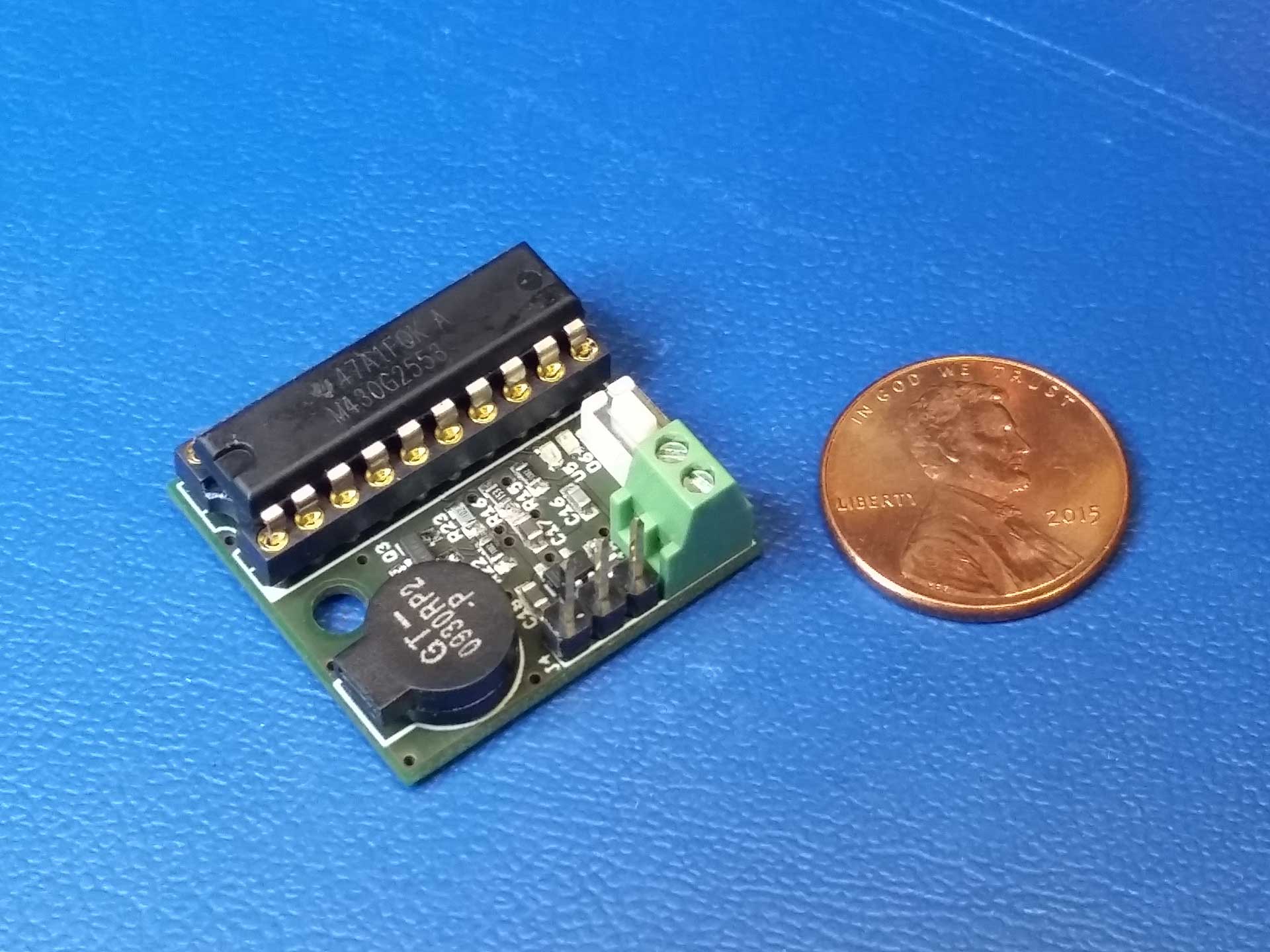

Re: Interfacing to the new HE280 accelerometer...
Postby U.S. Water Rockets » Thu Oct 27, 2016 12:34 am
mhackney wrote:It's not the assembly I need help with yet, its the design of the board from the prototype.
I'd be happy to help out with that, if you settle on a design.
If I understand what you're looking for, it would be very similar to my recent altimeter project. Is this the sort of thing you're looking for?
ULTIMATE 3D JEDDI
Posts: 5411
Postby mhackney » Thu Oct 27, 2016 7:13 pm
Basically. It will need the HE280 connector on one long edge and pads for the 8 wires on the other. The processor chip and 5v regulator (maybe depending on processor) and an LED to show the touch and relay messages on startup. I'm also thinking a row of four 2 pin headers to use for setting the sensitivity with jumpers and another to select NO or NC behavior. I can write this up and also make a drawing of the basic format and how I'd like to attach it between the whip and hot end.
