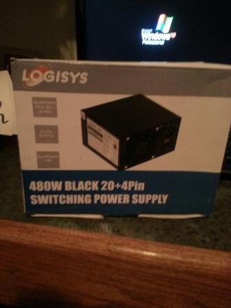

Postby summyman » Thu Jul 18, 2013 11:37 pm
Xavier,
I am having the exact same problem with my Rostock. I re-verified that I have 4 power wires to the bed. Here is a picture of the power supply box that housed the ps that came with my Rostock from seemecnc. I think I will try to add another set of power conductors to the bed heater by using the ones I dedicated for powering the fan and add a second power supply for the fan.

My second power supply (in 4 months) bit the dust last night. I'm shopping for a different, better one today.
What I'm learning is that the 480 watt rating of these supplies isn't all available to the +12v output. At 12vdc, the OEM Logisys only provides 16A of current. This equals only 192 watts of the 480 that the supply is capable of producing. Keep in mind that the wattage rating on the box for something like this is usually the max max max that it can possibly produce. In common practice, you can only reasonably expect a device to perform at RMS (.707) of its specified max wattage, and that's if they're being honest with the rating on the box. That's also not usually recommended to run anything 'turned to 11' for an extended period of time. Anyway, that was the long drawn out way of expressing that you're probably only capable of sustaining 50% of the specified current draw on something like this, so I wouldn't expect to get more than 8 *real* amps out of the OEM power supply.
So... With a 3ohm bed and 5.5ohm hot-end that both run on 12v, you're drawing a full 6 amps before taking all 4 stepper motors and the Rambo board itself into account (plus any fans, LEDs, powered end-stops, and whatever else you're using)... I bet that's at least 10 or 12 amps when everything is moving, and there's just no headroom for the power supply to operate happily under the load.
If I was building a machine like this from scratch, and had done the above math in the design stage, I would not recommend a power supply that was rated for less than 25A @ 12Vdc. That's what I intend to buy at a minimum, I'll let you know what deals I find.

The 16 Amp OEM unit can be had on Newegg for about $17. For a cheap upgrade ($22) to a 25 Amp unit, check out this one: http://www.newegg.com/Product/Product.a ... 6817170028

I would strongly recommend, if you are going to use a computer power supply, looking at the ones that multiple 12v rails. Jimustanguitar is right the 12V rail of these el'cheapos does not have enough umph to supply the Rambo. Using a dual 12v rail model allows for separating the load produced by the hot bed from the motors and electronics.
Typically multiple rail ATX power supplies have one rail that is able to higher currents (the bed) and one or more that are designed for less (everything else). It is also worth noting that most ATX power supplies will struggle to produce amperage on the 12v rail without at least a little load on the 5v line.

Keep in mind that I'm biased -- my Logisys caught fire before I ever powered it on. That said, there's no way I'd buy another Logisys with just marginally more amperage on the +12V rail. There are lots of good power supply vendors out there. The thing is, the good supplies cost more than $25.
