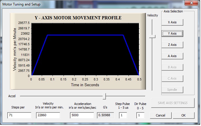

Ok, Here is my Z Axis tuning. It's been working great for me.

Unfortunately, we can't post the Mach XML file here. I wrote the manuals and the configs in this thread that I posted are what I'll put in the 4 axis Electronics Manual. Just look at my screen shots at the start of the thread. I inadvertently left out the z motor tuning, that was posted yesterday.

Mastercaster all diagrams posted by me have been verified to be working diagrams.
Mtizle

In my "SeeMeAdmin" post above (on top of second page), The Z and A axis dip switches should be set the same, for 1/8 stepping. X and Y are set for 16th microstepping.

Below are my Motor Tuning Profiles. They turned out to be double of that of mhackney's configs. I also had to reverse the motor direction for the correct + and - direction.

You probably have your 34 Axis board configured for a different micro step than I do, that's why your steps per are doubled. I think I have mine configured for 1/8 stepping. How is yours configured?

No idea what the stepping is... is that configured on the board by the jumpers? My jumper settings came from Steve's with Seemecnc. So you think it could be set to 1/16 micro step right now?

Tizle, yeah, the board you looked at up in the lobby was 1/16 stepping.
