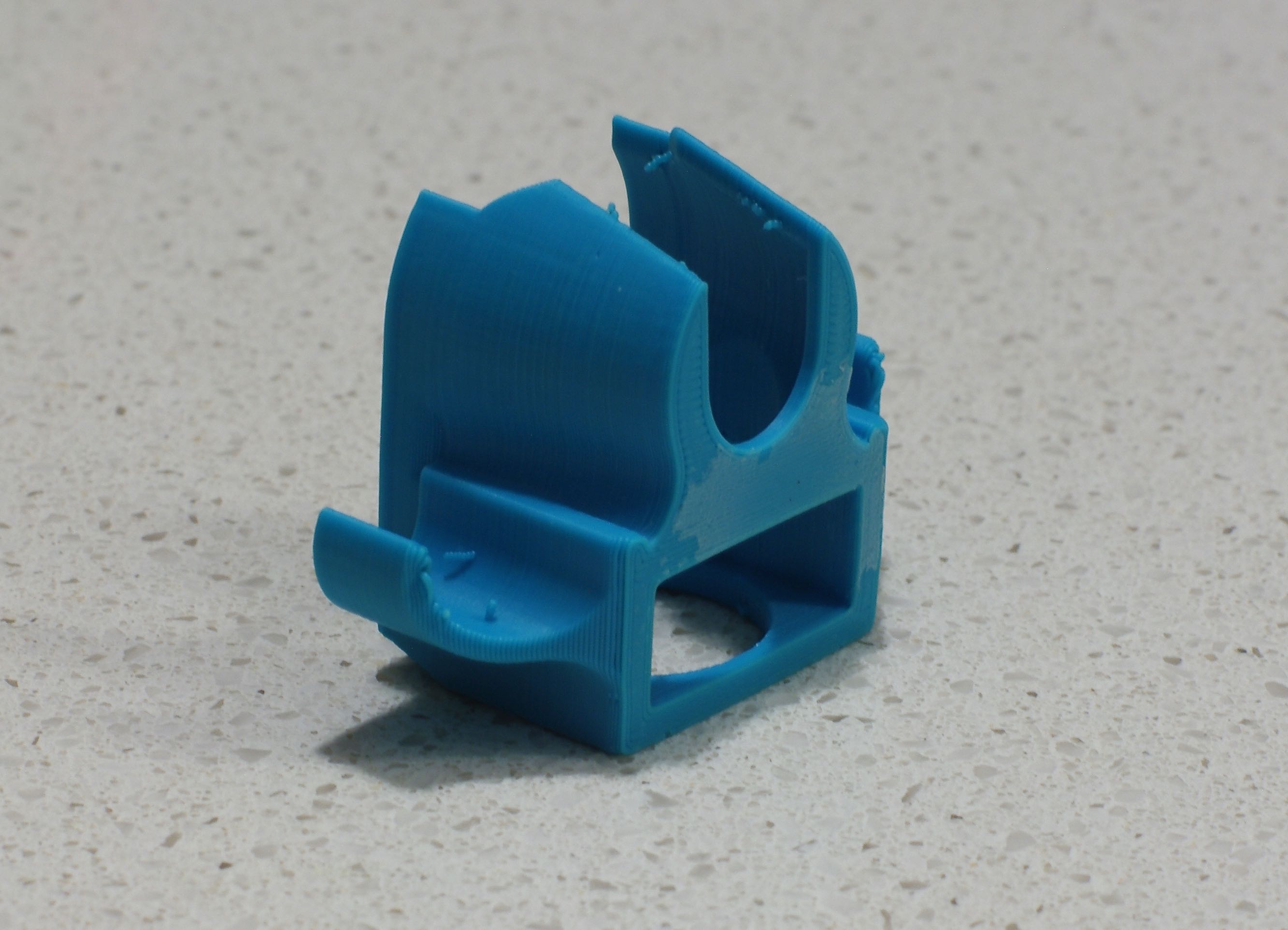

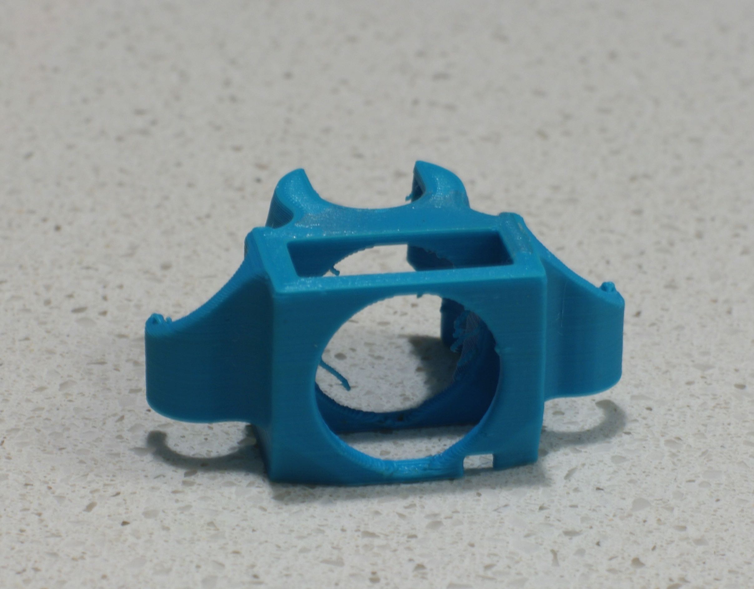

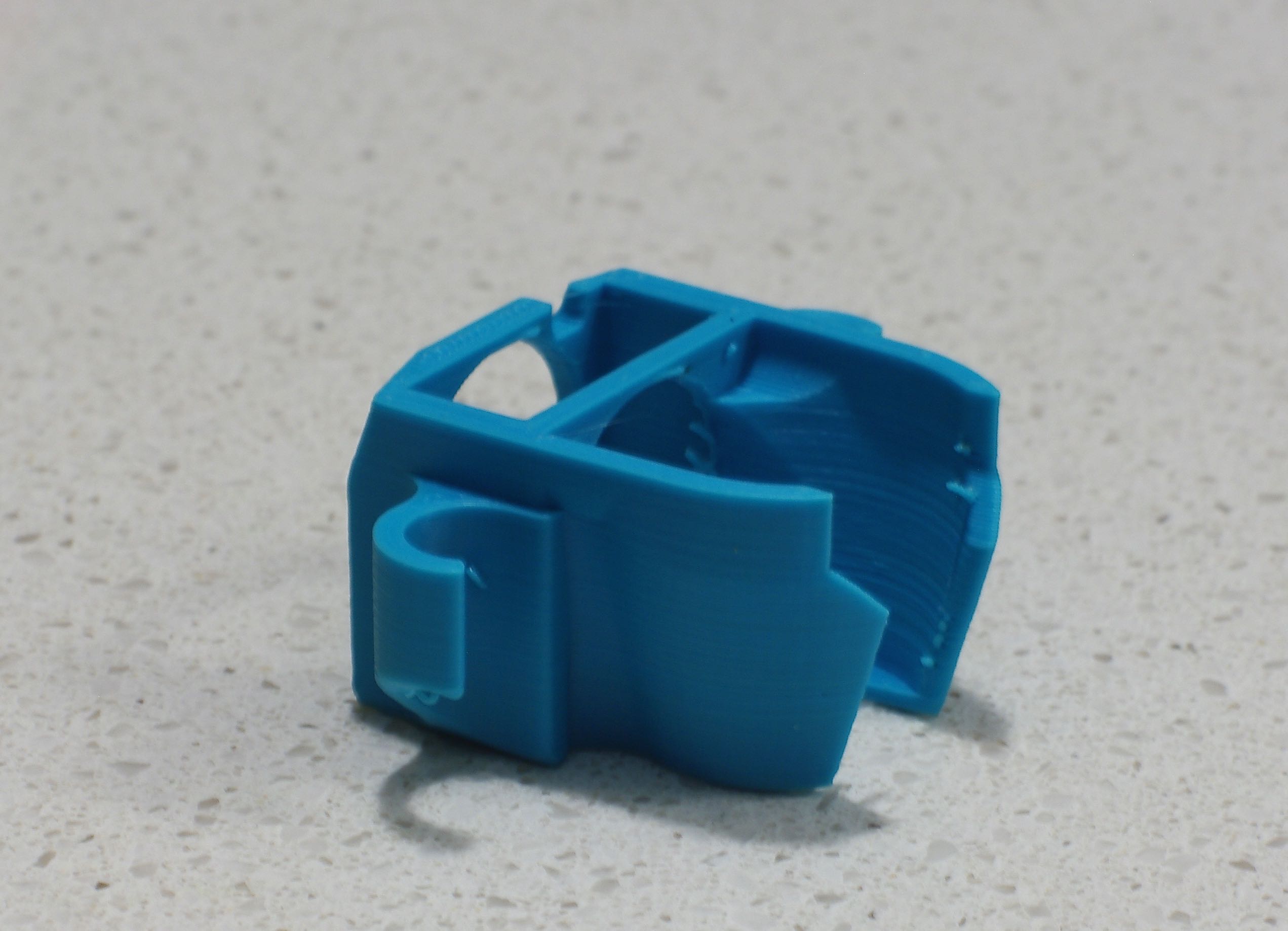

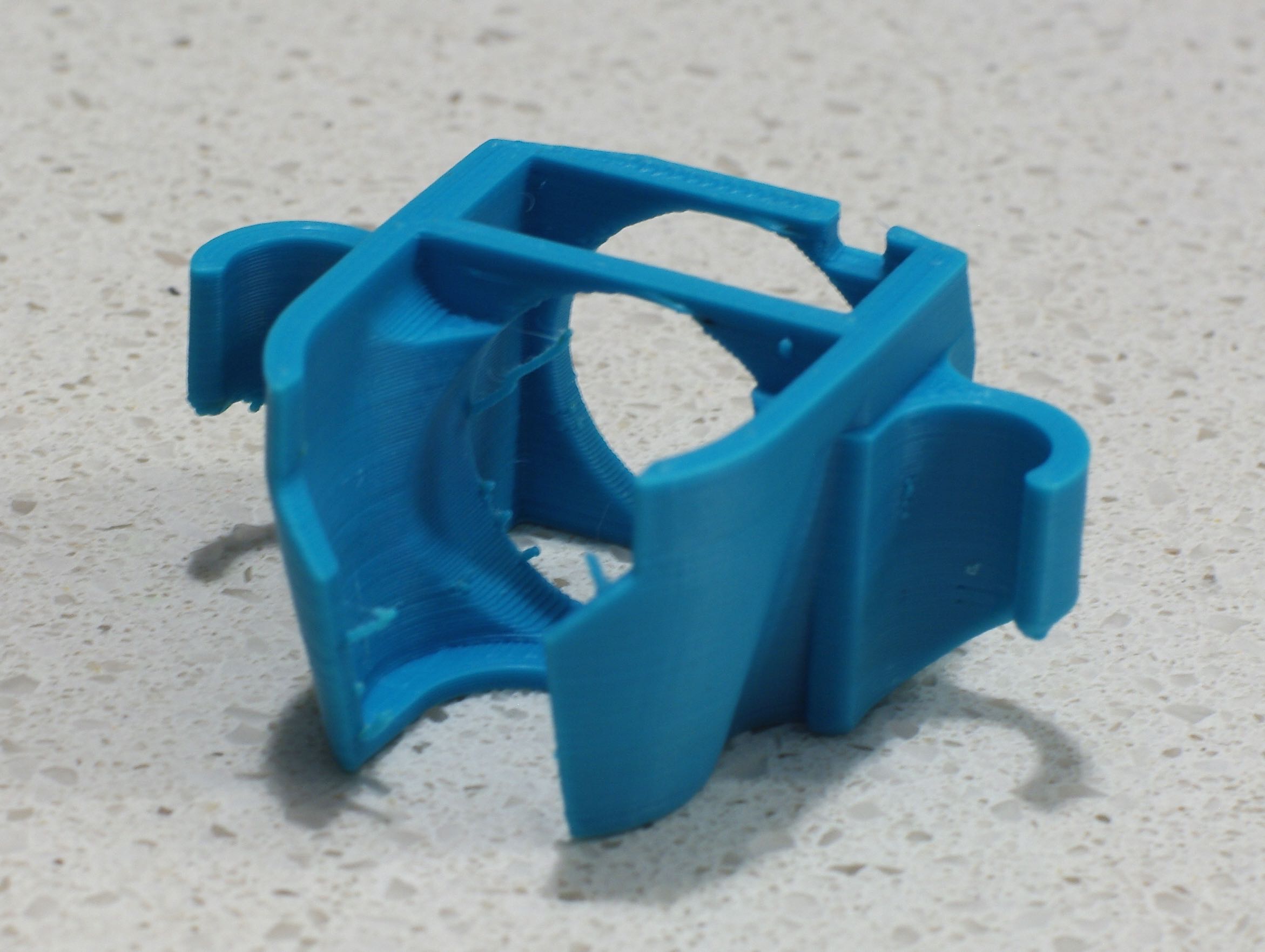

I have just finished my first print, being the ABS fan shroud and it has come out much much better than I expected. I think the overall quality, especially on the outer surfaces is very good. Im very impressed with the printer!
I had a few false starts getting bed adhesion on the first bead of ABS with the glue stick but probably didn't apply enough in retrospect. Either way for the 4th attempt I upped the bed to 95c and used my wife's hairspray and it went perfectly from there. :D Thanks honey. She was very happy for me but did ask nicely that I buy some cheaper hairspray tomorrow and not use her expensive Redken :D
In terms of things to improve (in bold) from what I can see. The boogers, I believe these are cause by over extrusion? I will calibrate my E steps and extrusion multipler tomorrow which I think will help this a lot from what I have read on the forums here. I watched the print closely and most of these occurred when the hot end quickly flew from one side of the object to the other so maybe retraction also?
The only other thing that concerned me during the print was that there was an odd low pitched buzzing noise coming from the extruder. It started after about 2 minutes into the print, got louder up to about 5 mins then stayed the same. It sounded a bit like a bee but lower pitched. This could be the over extrusion again?

I reckon you have got it pretty well calibrated, nice first print.

Calibrated my extrusion multipler today and that has improved the boogers a lot. Still need to do esteps, flow rate and retracts tomorrow but going much better. Printed my layer fan which came out very well. Still having troubles getting the abs to stick which resulted in a failed print halfway through but im starting to get that sorted now.
Slicer is matterslice
