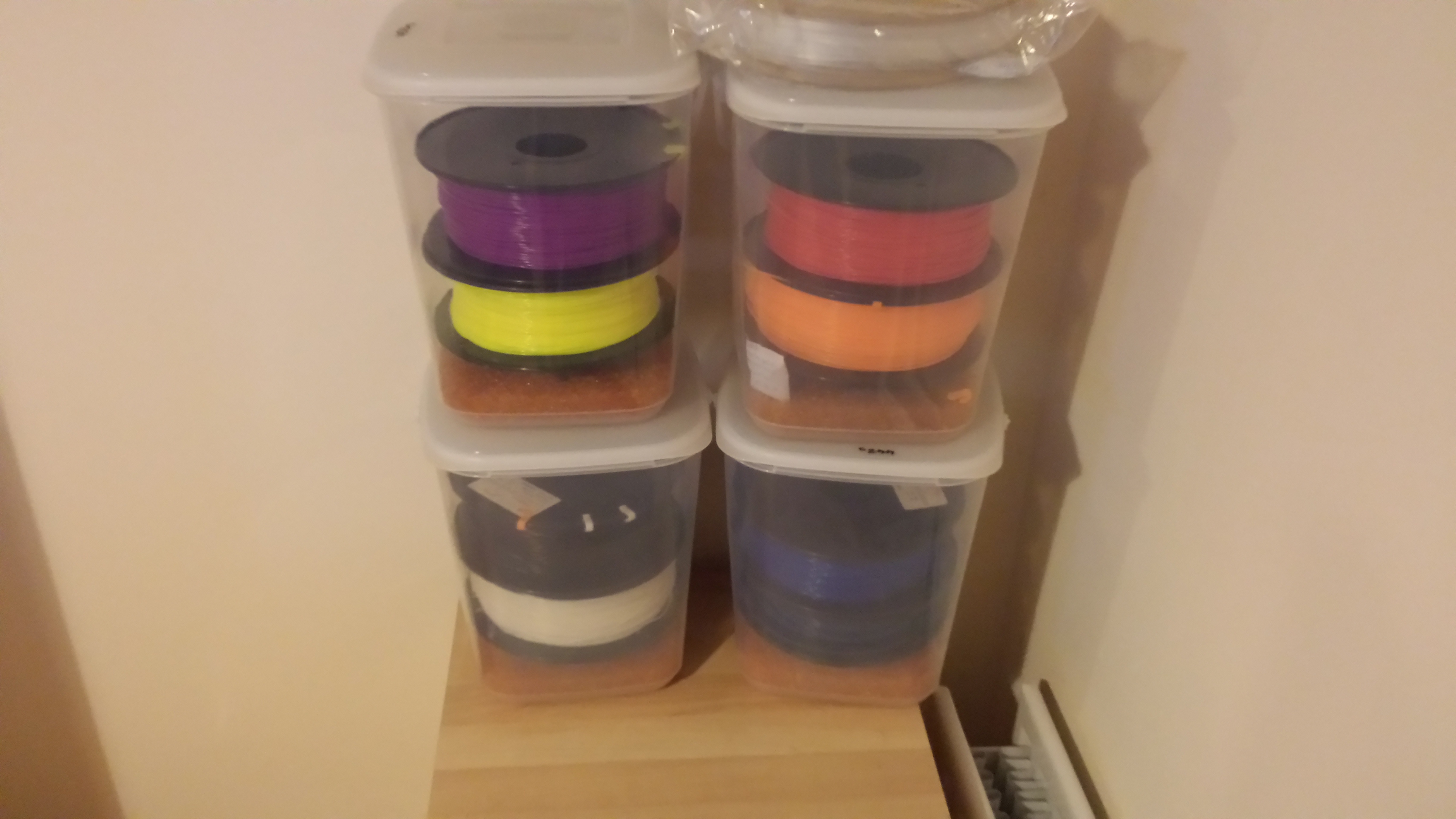

Many people buy some Tupperware to store their filament in with some desiccant. I got some of the large (10 litre) sealable tubs from Morrisons (£3 each) and I get 3X 1kg reels in each. I bought indicating Silica Gel from Ebay for the desiccant.
only got 2X in each in the photo but you can fit 3 in.
