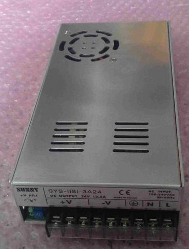

what power supply are you going to upgrade to also fit the max ?
cheers
joe
Re: firmware
Hey guys, you are of course welcome to go off and experiment on your own. I have already ordered and am expecting the 24V 16Amp power supply to arrive next week. I am also checking with Steve to see if the Onyx can handle the higher current. If it can't that's the end of the line for Onyx in terms of adding more juice. I am running mine at 15 volts as it turns out and that seems to be within the margin for safety. How much higher we can go, I don't know yet but will let everyone know when I find out!

makerof3d wrote:what power supply are you going to upgrade to also fit the max ?
cheers
joe
Its not here yet, but it should look like this:
I'll have to exchange this fuse anyway, because it's only designed for 16V.
