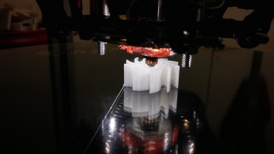

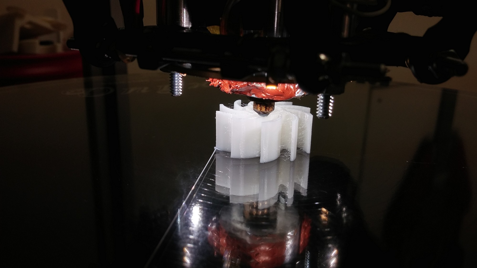

So S3D crashed and burned on my latest print. For some reason it's all blobby.So I switched over to KISS version 1.5 beta 2.16 and it printed much better, apart from some sparce infill and a shit ton of really fine strings. The strings aren't causing any part functionality problems. It just looks bad. I'm not quite sure what to set my prime/suck/wipe values. I'm printing PLA at 200C. Any tips?

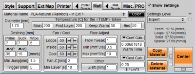

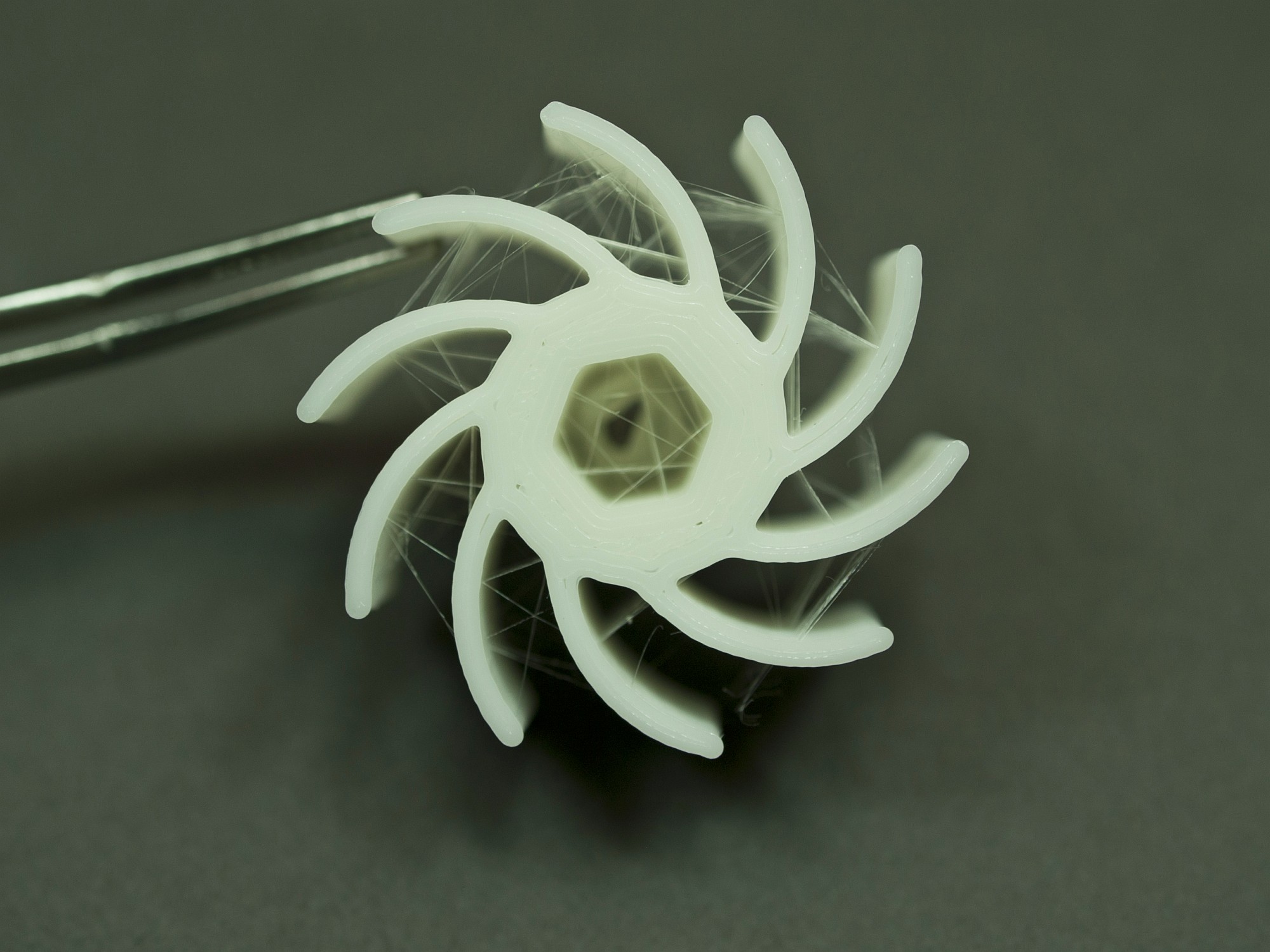

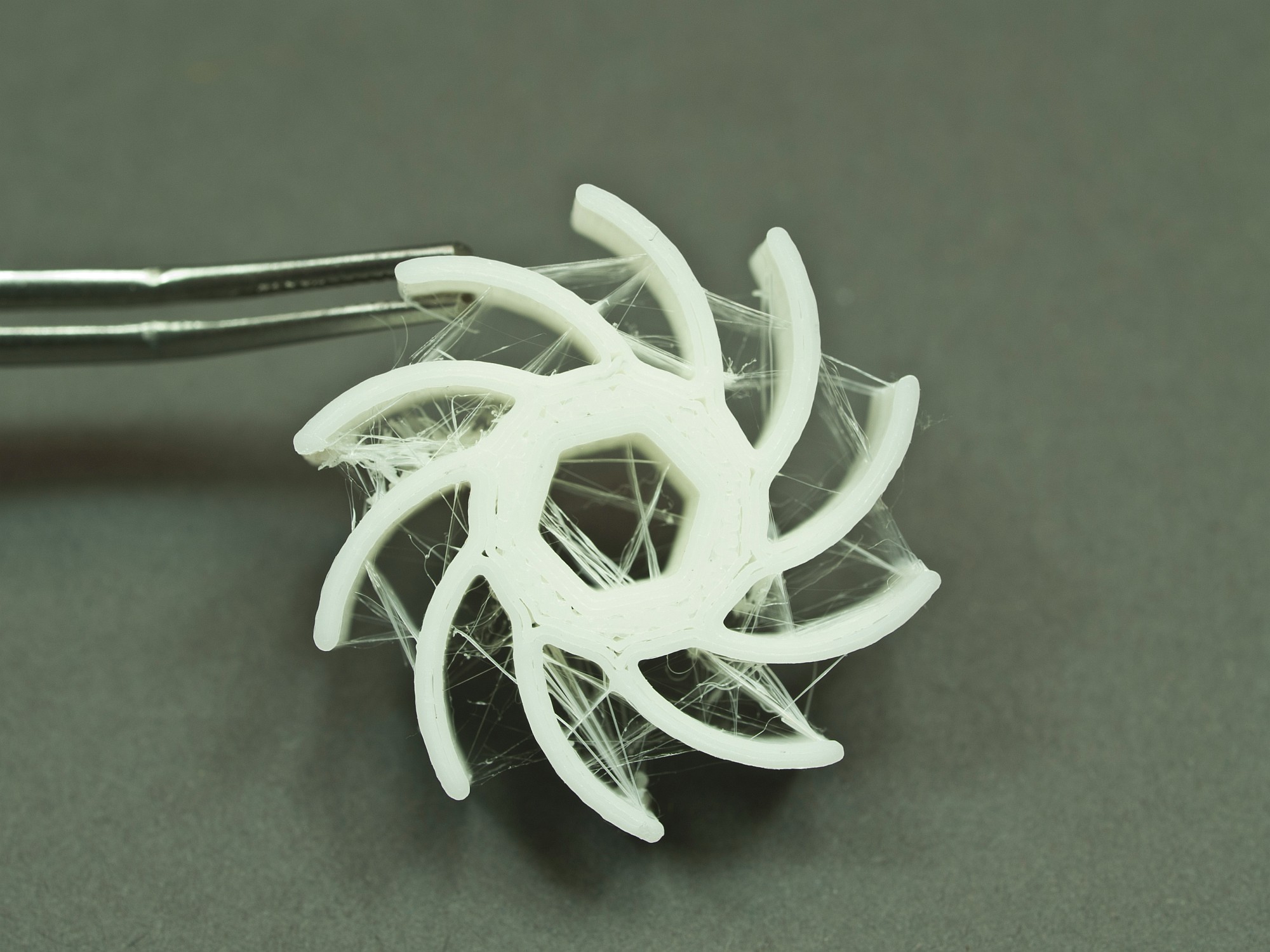

This isn't exactly an apples to apples comparison. I tried the mhackney settings BUT I tried to print at 100 micron. I noticed that it was really getting stringy so I stopped the print. I was squirting at 195C.
The next one I did, I moved to 5 prime, 5 suck, 5 wipe, 45vP, 25vS, 2 trigger, .4 z-lift, and 200 micron layers. I ran half the part at 195C and then bumped it down to 190C on the printer. No skips. Reduced strings but they are still there. Obviously, I broke the cardinal rule by adjusting more than one setting at a time. I'm happy with the quality of the print. Not a single blob anywhere. Only the strings.
