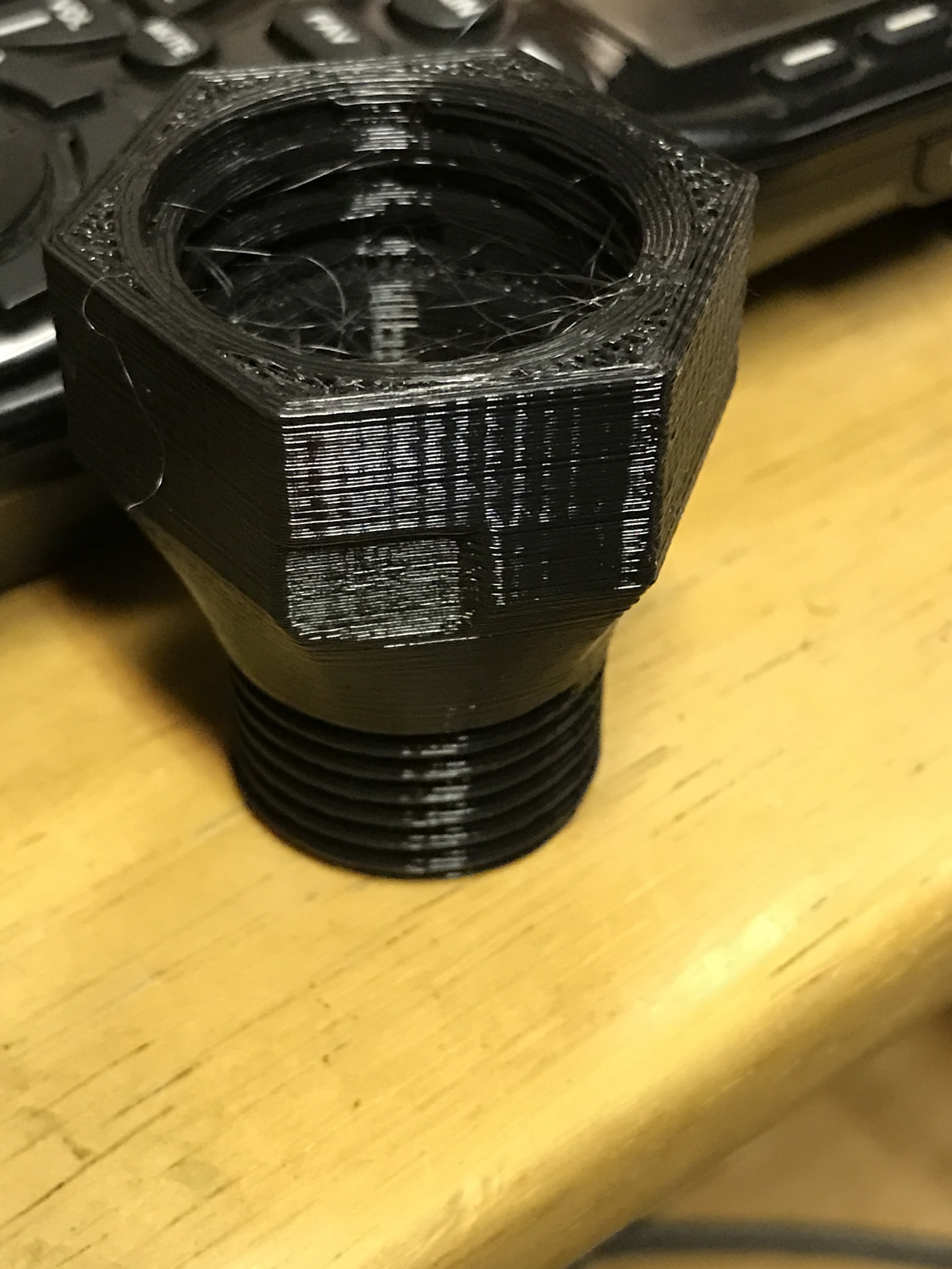

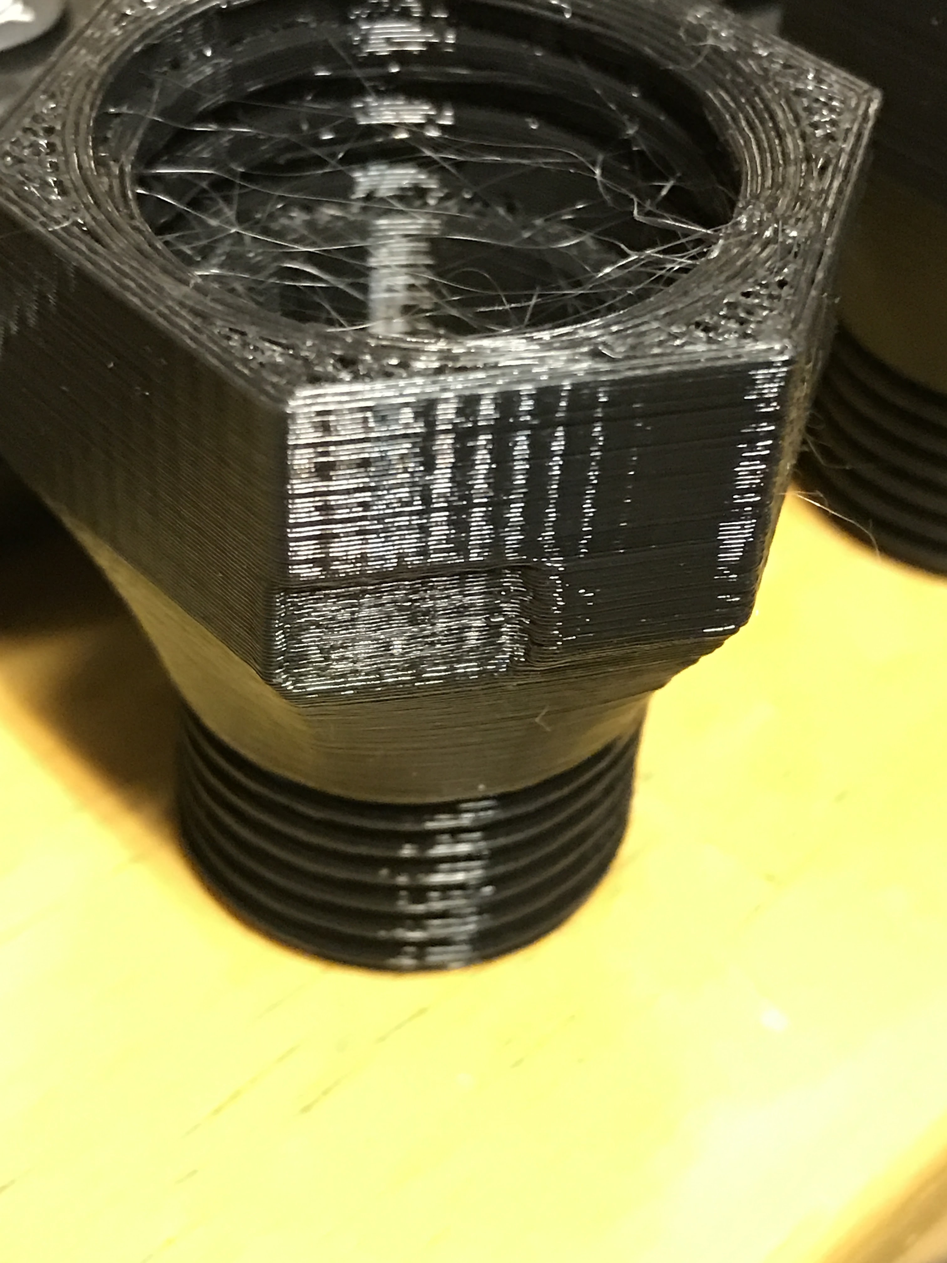

Does anyone know of a KISSlicer bug in 1.5 where sidewall artifacts can be introduced when you make multiple copies of something? I have an STL that when I make 6x of them, 1/6 has the artifact, when I make 7 2/7 have the artifact. 1x,2x,3x,4x are fine running a test on 5x now. It doesn't appear to be the printer because one of the ones with the artifact is dead center which is where the 1x copy is printed and never has the issue. The artifact is an indention in the sidewall for 6-8mm in layers and about that in width. Same exact location on all of the "bad" prints. The sidewalls are in a hexagon shape with the artifact only on one of the six sides.

Cura didn't load for me, but MatterControl did. I don't see the defect in Matter control. Not sure what to look at next. I will get a picture loaded to see if anyone else has ideas.

So... 1,2,3,4x copies print fine. 5,6,7 have issues on one or more of them. Cura graphical looks good, but I can't imagine that it is a mechanical issue due to the consistency of the issue, the fact that the center of the bed is fine for 1 copy, and has the sidewall error on the 6 and 7x multiples. Any other ideas?

I think the STL looks ok, Blender found 11 thin faces, 1 sharp edge and 2464 Overhang faces. Everything else was 0.
I am trying a couple small changes to the slicing like Infill % and rotate to see if it makes a difference.
morgandc
Posts: 279
Re: KISS multiple copy bug?
Postby morgandc » Sat Mar 18, 2017 1:13 pm
Looks like rotating the STL 90 degrees avoids the sidewall bug on 6 copies, testing will continue.
