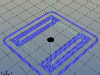

Post by ahgu » Fri May 02, 2014 10:06 pm
I added the same stl twice, gave it some spacing, goto print, show one layer only, it still shows going back and forth.
see picture.

Post by Eaglezsoar » Sat May 03, 2014 9:20 am
If you have the sequential printing box checked, try the print irregardless of what the layers show.
Slic3R is full of "bugs" and I would try the actual print and see if it does it sequentially, if not you can stop the print before you waste filament.
That sequential print box is the only way I know of to tell Slic3R to print sequentially.

Post by ahgu » Sat May 03, 2014 10:02 am
Tried printing, no difference, it still go over to the other one to drop something small and then come back.

Post by Eaglezsoar » Thu May 08, 2014 5:50 pm
ahgu wrote:Have you tried something simple and get the same result?
Looks like a bug in the software, see this link: http://www.soliforum.com/topic/5037/rep ... ing-issue/

Post by shapeshifter » Mon Nov 03, 2014 11:57 pm
I am facing the same issue but it looks like it's slic3r and repetier not talking properly, apparently it works if you open slic3r separately and just slice in that not via repetier... I'll try it later and let you know if it works... Here's the GitHub link to the issue:
https://github.com/repetier/Repetier-Host/issues/307
