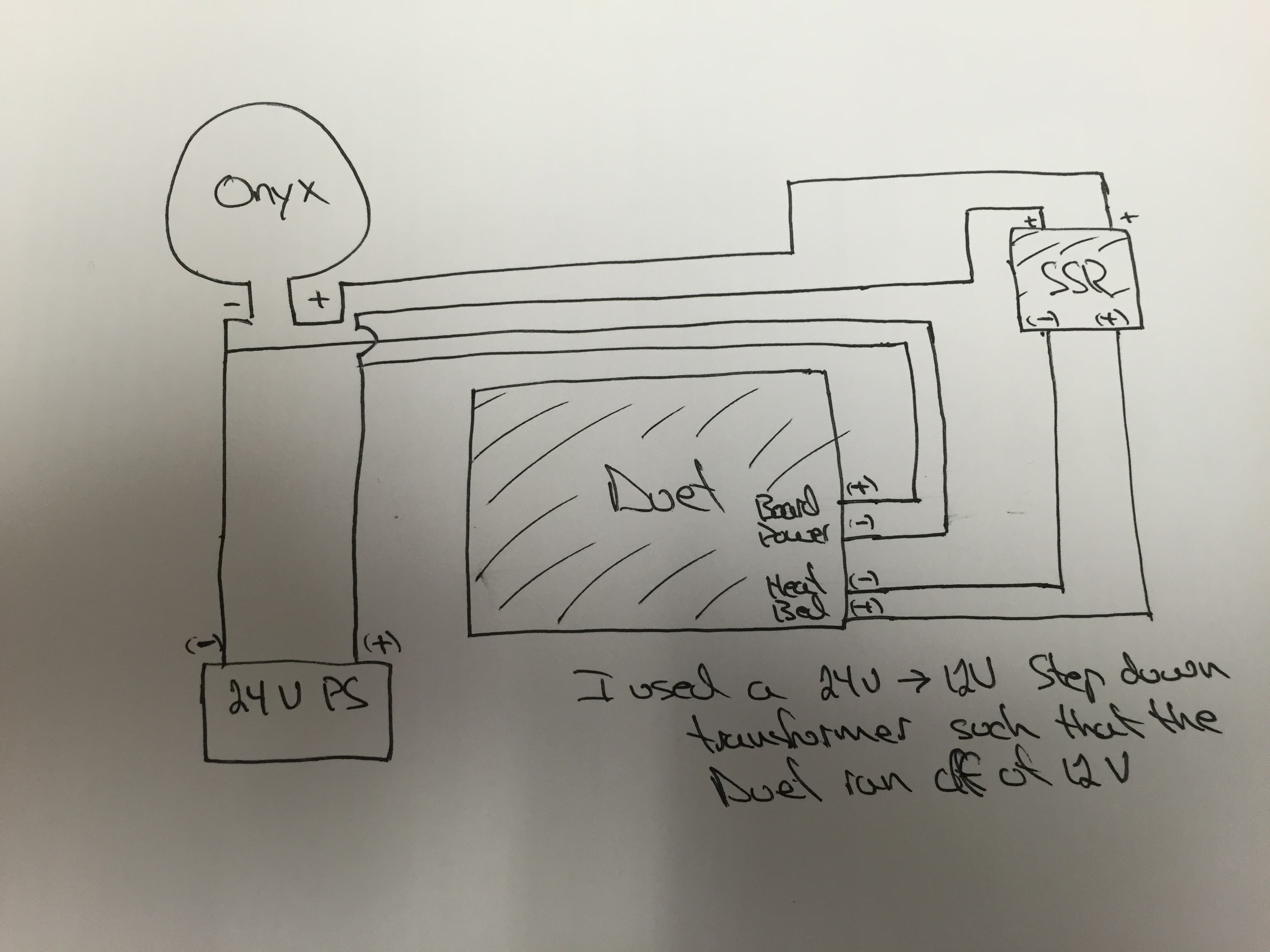

ddpruitt wrote:Using an SSR necessarily requires me to use two power supplies?
Also, if I do use two power supplies can they both still be 24V?
No you can use one PS. The duet will power and control the SSR which you use to relay 24V to the Onyx.
It is not a great sketch but this is what I did.

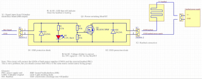

mine is working with a mosfet.
cheaper and cooler than a ssr

lordgort wrote:mine is working with a mosfet.
Don't mosfets typically fail in a short circuit? That can't be good for the Onyx, or your house. :shock:

Postby lordgort » Wed Apr 13, 2016 4:29 am
In the case of a failing controller the pin goes high imp mode. for that case there is R3 (in the picture) which causes the mosfet to "shut off"
for other failure cases you really need to cook the mosfet with 260 amp.
im using this with 12v, so im fine. with 24v you should use a fuse to protect your bed... just a few pennys more
//for 12v on the controller-side R1 is 1k, R2 is 10k and R3 is 60k
//in the picture i posted a 24v controller was used
