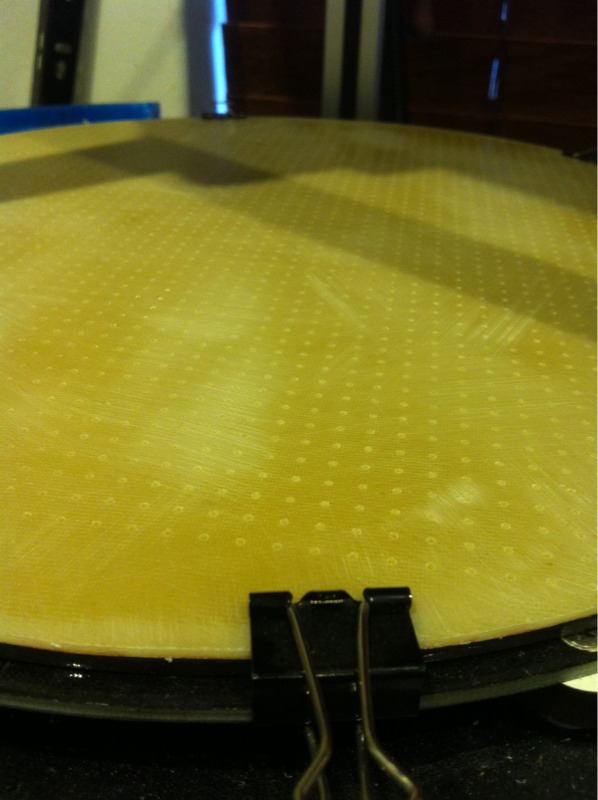

First garolite, aka a 300x300mm sheet of single sided PCB from Jaycar, drilled and cut to a circle and sanded on both sides. Clipped straight onto the glass. The copper side even acts as a bit of a heat spreader!
Just dialling it in now, hopeful for good results on nylon and ABS.

ABS so far is shite. Tacks down in some places, drags around in others. I suspect combination of rough/smooth patches and maybe high/low spots. At work we use ABS all the time so the easy fix was ABS juice over the board and it stuck really well. But I'm going to be playing with Nylon as well so not sure I want to do that just yet.

Nylon supposedly sticks very well to perforated PCBs. I wanna pick up a cheap one like you did sometime and try it out, just don't know where I can get something that size locally..
