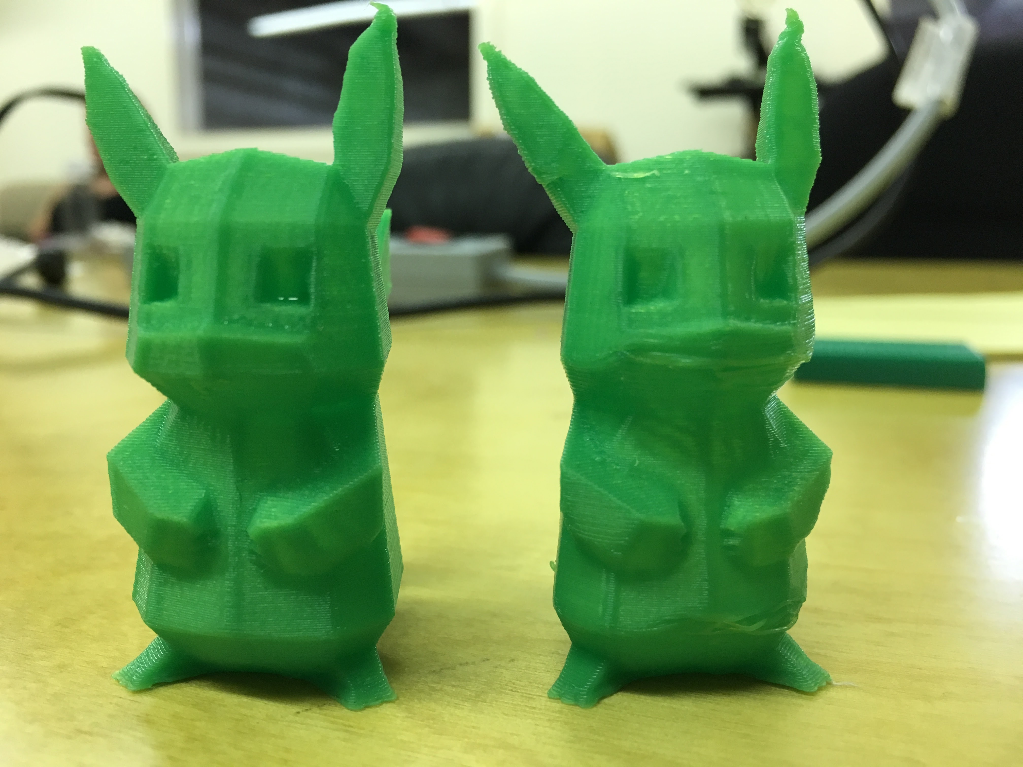

Some sample parts using the new BerdAir Max - much better cooling. These parts were printed with 0% infill and two outer shells on my Graber I3. I kept the temperature settings the same and used the same GCODE for each print; the only change was switching to the Max pump. I'm driving the larger pump directly off of a super cheap RAMPS board with the original mosfet for speed control. The mosfet barely gets warm to the touch even after hours of printing.
The new kit is available at http://www.themakerhive.com/shop/viewitem.php?productid=28
BerdAir Max on the left, original BerdAir on the right
-Dan

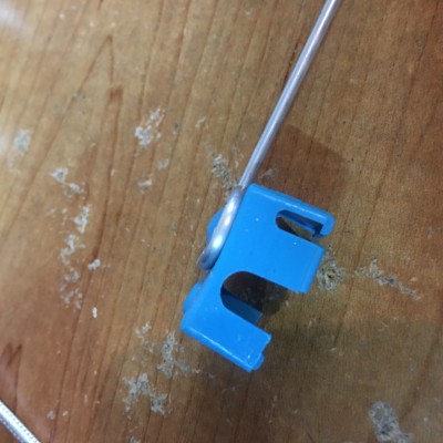

Postby Xenocrates » Fri Dec 02, 2016 6:51 pm
I like them a lot too. I do wish it was possible to get one sized to fit at the base of an E3D heater sock, as I found they didn't fit properly with one. Perhaps I should just buy some tubing and give it a shot myself.

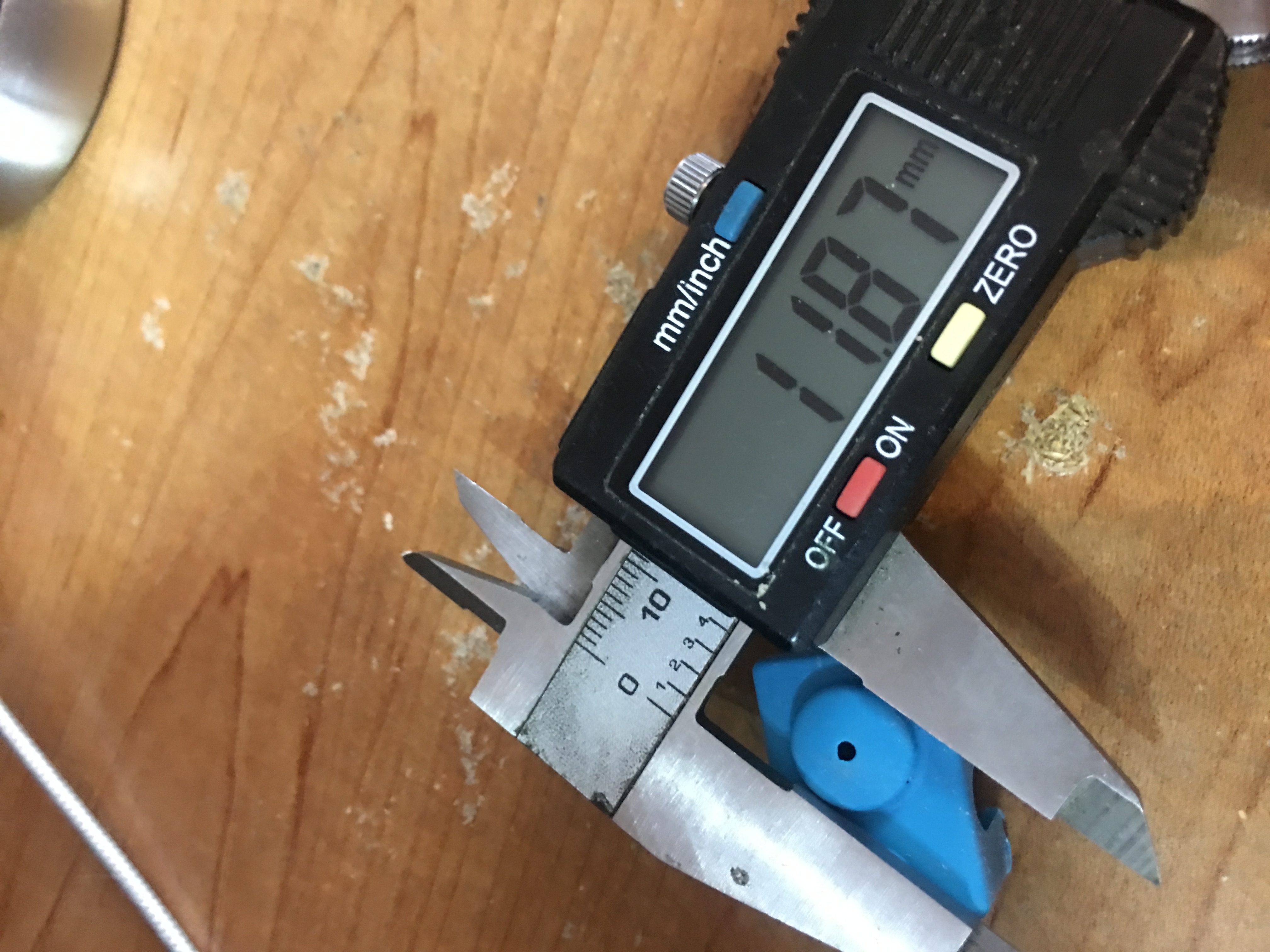

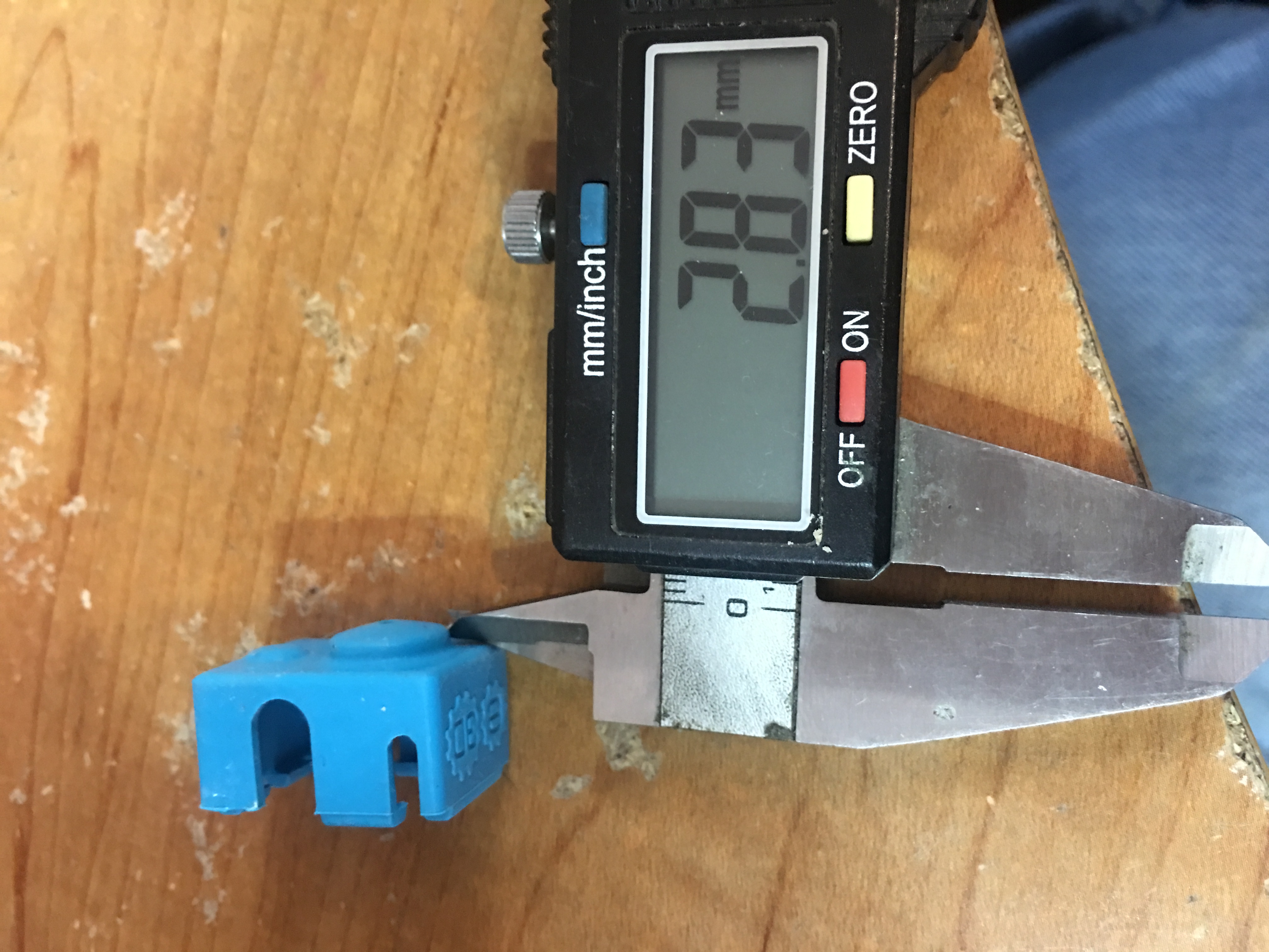

Xenocrates wrote:I like them a lot too. I do wish it was possible to get one sized to fit at the base of an E3D heater sock, as I found they didn't fit properly with one. Perhaps I should just buy some tubing and give it a shot myself.
How big do you need the inner diameter to be? I can adjust the circle to fit larger nozzles.

Postby mhackney » Sat Jan 07, 2017 1:25 pm
Yes, the E3D sock is quite useful and I've modified my air tubes to fit over a couple of printers with them. It is nominally 12mm diameter and about 3mm tall. Here is a photo of a slightly expanded BerdAir tube wrapped around it.
I don't think you need to change your design, as it is the aluminum tube nicely snugs and is held on the sock.
ULTIMATE 3D JEDDI
Posts: 1489
Re: BerdAir comeing soon From Yellow Jacket Concepts
Postby Xenocrates » Sat Jan 07, 2017 1:39 pm
funnily enough, the spare tube I have fits over them without issue, while the one that I actually use currently is a little tight. If there's any adjustment needed, it's on the sub-millimeter scale overall. Perhaps I just suck at bending tubing.

Postby Jassper » Sat Jan 07, 2017 3:52 pm
Ah - OK. If the ring is a bit tight, hold the ring in your left hand and grasp the ring between your thumb and for-finger. Then carefully pull the ring open a bit with your right hand, pulling on the straight part. Very little movement is needed, be careful not to pull to hard as the holes make the tubing weak and my bend or break.
I will order a sock and make sure the ring fits for the future!
